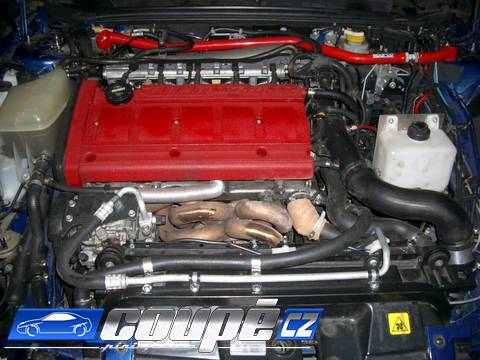

    Engine:
    - 2,4l engine from Barbz
    - big valve head additionally ported from previous F1-engine- builder Hartmut Lohmann (grinding shop for cylinder head BMW Formula One and optimizing of rods), Ferrea valves
    - complete inlet system (plenum etc.) ported by hartmut as well
    - C&B cams
    - Big Garret IC rated for 600HP
    - 4" inlet
    - KMS free programmable ECU
    - custom made manifold (Cufaro Racing) with T3 flange
    - custom made dual flow exhaust with 2x63mm into 3" at the end
    - GT3082R with external WG TIAL 44mm

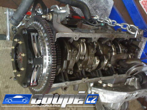

    - Dual paddle clutch with very light flywheel (about 4,5kg) from Cufaro Racing

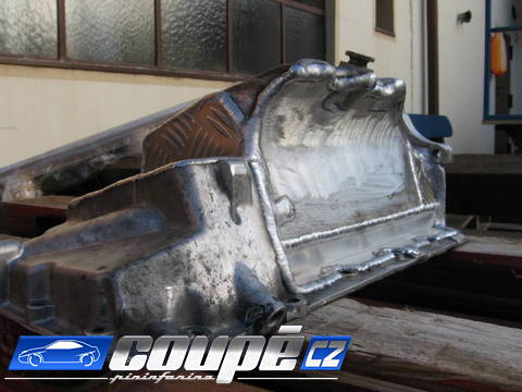

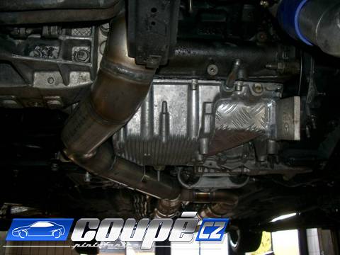

    - the oil sump... you need to modify the original oil sump - we cut away some parts from the original one and welded it again... this was a sh... job!
    Attention: provide enough baffle plates – else you will get problems with oil pressure in quick corners… (like me L)

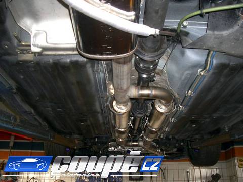

    - a new downpipe + exhaust - I welded a custom part.

    krosmen vzťahuje sa to k tomuto obrázku ?
    http://img504.imageshack.us/img504/369/sump.jpg
    http://img268.imageshack.us/img268/2095/exhaus2.jp g
