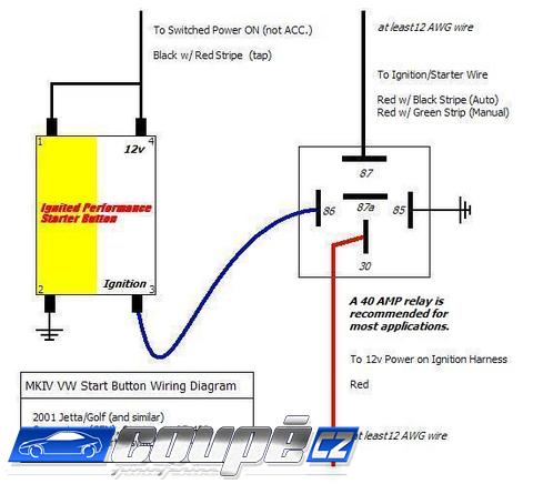

    Diky Honzo tak to zkusim zitra,kupil som Startovaci tlacitko 12V 50A dufam ze to staci...
  • krisz
    Akurat nevim presne ktore kable mam zapajat zo skrine aby to fungovalo dobre,a nemusim mat ohranu na to ze pri nastartovanom motore este raz stisknem start. gombik,dam na dobre misto...
  • krisz
    odkaz nefunguje takto pridam...
  • krisz
    http://api.viglink.com/api/click?format=go&key =8467fb2c3ea02b25e956b69f0fe74a93&loc=http%3A% 2F%2Fforums.vwvortex.com%2Fshowthread.php%3F118860 9&v=1&libId=d023eedd-08ac-45e8-89c8-7fb78b 98a31e&out=http%3A%2F%2Fpicasaweb.google.com%2 Ftaplive%2FEngineStartButton%2Fphoto%2352100998227 79616130&ref=https%3A%2F%2Fwww.google.cz%2F&am p;title=VWVortex.com%20-%20Engine%20Start%20Button %20Installed%20(short%20write-up%20w%2F%20pics)&txt=%3Cimg%20src%3D%22http%3A%2F%2Flh3.ggpht.com%2Ftaplive%2FSE3-Lz0ay4I%2FAAAAAAAABcI%2F1AJLDDaE9VA%2Fs800%2FStarter%2520Button.JPG%22%20border%3D%220%22%3E&jsonp=vglnk_jsonp_13766497342957 Nasiel som tento zapojeni da sa to podla toho udelat?
  • Morris_3nec
    urcite slo, uz na to nekde je tema kde se to resilo, i s nakresama a pouzityma soucastkama
  • krisz
    Caote,dalo by sa zapojit startovaci tlacitko do 16VT nejak jednoduse? Mam tam aj imo,ci by bolo problem,urobil uz to nekdo?
