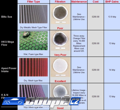

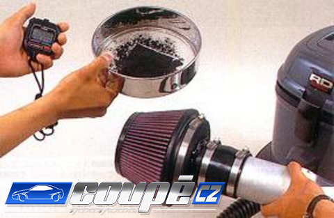

The filters were tested on the quality of the filtration, simulated by using a vacuum cleaner and millions of microscopic dirt particles. The particles that penetrated the air filter, were collected on a secondary paper filter, so that a fair comparison could be performed, and the results could be compared like for like. As well as the fine particle test, the performance gains were also measured using each of the induction kits in the test. Therefore, in the quest to find the ultimate induction kit, the filters must not only filter the particles out efficiently, but must maximize the amount of clean air flow, through the filter. The winner would be the induction kit that filters the most dirt particles, whilst acheiving the maxmimum power output of the vehicle.

Jo jo je to z nějakého supra fora jak píše Honza: XXXL PS, ale nefunguje mi odkaz. Dával jsem to sem hlavně k porovnání filtrace.

no přidat to může..jelikož to je tabulka z nějakýho suprafora-pokud to bylo bržděný na nějaký XXX PS bestii a porovnáváno oproti origo papíráku v neupraveným filtrboxu...
18:33:52 21.9.2009
Martine ta tabulka má vypovídací hodnotu 0 když tam tvrdí že vložka filtru přidá 13 kobyl, to je zas nějakej reklamní blaf

Pekny srovnání..Ten od HKS dali snad do fejfucku dieslaku ne?:D

Apexi
