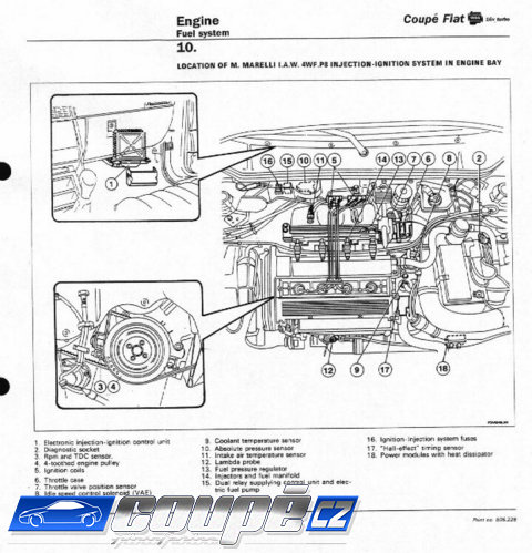

13:39:07 18.8.2009
15-dual realy supplying control unit and electric fuel pump
13:32:03 18.8.2009
podle me je to zpusobene timto je to 15
